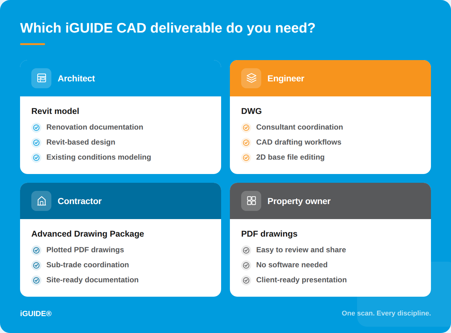

Question 3: Who will be using the files?
It depends on their workflow. Architects typically need a Revit model, engineers a DWG, contractors an Advanced Drawing Package and clients or property owners a PDF.
A firm providing both architectural and construction services might order a Revit model for internal design work and an Advanced Drawing Package so their sub-trades have the plotted PDFs and DWG they need for coordination, without waiting on a Revit export.
If you're a Capture Pro providing documentation to a third party, it's worth asking how that firm works before you order on their behalf. A team running CAD may only need the DWG. A team running Revit may want to skip straight to the model.
