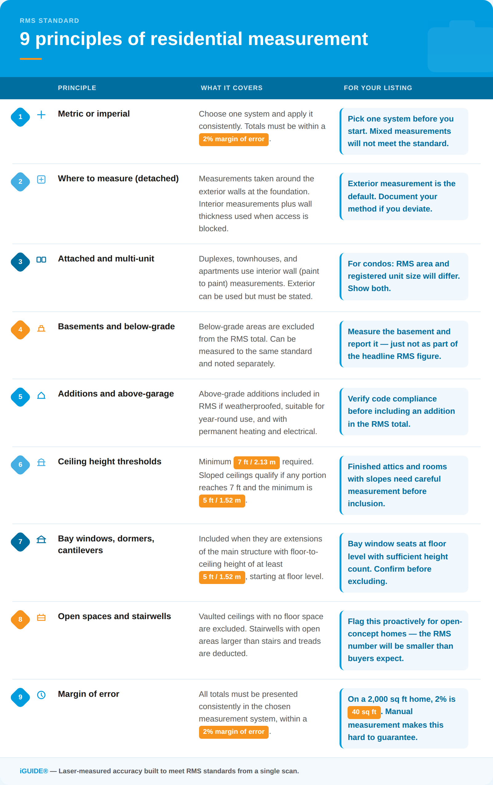

The 9 RMS principles, and what they mean for your listings
Each principle addresses a specific measurement scenario that comes up regularly in residential listings.

Does RMS apply to condominiums?
RMS does apply to condominiums, but with an important distinction. RMS for condominiums uses interior wall measurements (paint to paint) rather than the exterior measurements used for detached properties. The RMS area for a condo unit is not the same as the registered condominium unit size. These two figures will typically differ and should be presented separately in the listing.
How is below-grade space treated under RMS?
Under RMS, below-grade space, including finished basements, is excluded from the RMS total. It can be measured to the same standard and reported separately as below-grade living area. A fully finished walkout basement adds real value to a listing — RMS just requires it be disclosed clearly as below-grade rather than folded into the headline square footage.
What happens if a listing doesn’t comply with RMS?
When a listing doesn't comply with RMS, it creates legal and professional risk for the agent and brokerage. If a property is listed with inaccurate square footage that does not meet RMS principles, the agent and brokerage may face complaints, fines, or liability if a buyer relied on the measurement in their purchase decision. Consistent use of a compliant measurement system is the most straightforward way to manage this risk.
Are open-concept spaces and vaulted ceilings included in RMS area?
Open-concept spaces and vaulted ceilings are not included in the RMS area. Vaulted ceilings and two-storey voids have no floor space and are excluded from the RMS total. Stairwells with open areas larger than the actual stairs and treads are also deducted. Only areas with usable floor space at the applicable ceiling height thresholds count toward gross living area.
